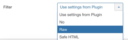

Accepted Answer
Pending Moderation
When creating the custom field, ensure that the Filter option is set to Raw or Safe HTML.
- more than a month ago
- # 5
Accepted Answer
Pending Moderation
it was already on Safe html,
with it's OK
THANKS !!!!
regards
with it's OK
THANKS !!!!
regards
