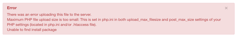

You do not have JCE Pro 2.7.15 installed on your site, and I was unable to do so as the PHP upload_max_filesize value on your server is set too low (3Mb or more is required), see the Joomla error below.
Please contact your host about this. After this issue is addressed, you will be able to install JCE Pro 2.7.15

Accepted Answer Pending Moderation
Problem is solved, php parameters are enlarged and I was able to install JCE 2.7.15 without problems.
And I see now the colors and indents in the code editor.
Many thanks for your support
